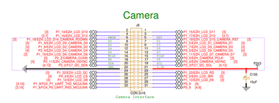

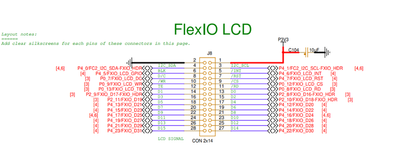

Download the schematic of the MCXN947 board from NXP's official website, and find the modules corresponding to Camera and FlexIO LCD, as shown below:
FlexIO is a flexible input/output (I/O) technology developed by NXP, used to provide high-speed, programmable communication capabilities between microcontrollers (MCU) and external devices. It allows developers to configure the FlexIO module inside the microcontroller to simulate various communication protocols and develop custom protocols.
Note: This LCD only supports 3V I/O voltage, so when configuring all pins on this connector, you must ensure they are all set to 3V3 operation mode.

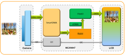

The following diagram shows the working principle of the SDK example, where the camera collects images and transmits them to the LCD display:
It can be seen that the LCD module does not have any pin conflicts with the pins required for Ethernet and Camera functions, while the pins required for configuring the Camera module are duplicated with Ethernet. The pin reuse can be found in the datasheet provided on the NXP official website as shown in the following table:

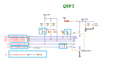

From the datasheet, P3_0, P3_1, P3_2, and P3_3 can serve as alternatives. However, P3_2 and P3_3 are already used for I²C. To resolve this, they are reassigned to P3_8 and P3_7 respectively (using kPORT_MuxAlt3).

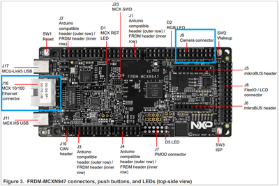

The reassigned pins (P3_0, P3_1, P3_7, P3_8) are not exposed on the board’s headers, but the schematic shows that they are connected to test pads TP12, TP31, TP18, and TP16. The camera can be wired to these pads directly.
Pin Name Solder Pad
P3_0 TP12
P3_1 TP31
P3_7 TP18
P3_8 TP16

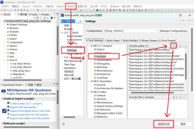

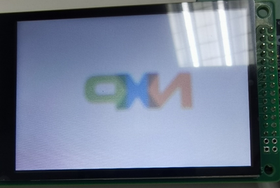

Integrate the smartdma_camera_flexio_mculcd example from display_examples into the lwip_ping_bm project. Merge .c and .h files from board, drivers, component, and source folders. Add these folders to the include path under Project -> Properties -> C/C++ Build -> Settings -> Includes.

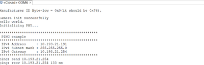

After integration, compile and flash the project to the board. The output is shown in the images.
Conclusion
The Ethernet and Camera functions can be simultaneously implemented on the MCX N947 board. The lwip_ping_bm demo showcases ICMP-based Ping functionality using the lwIP TCP/IP stack. It periodically sends ICMP echo requests to a PC and processes the replies.
The smartdma_camera_flexio_mculcd demo demonstrates how to use SmartDMA to capture image data frame-by-frame from the OV7670 camera and display it on the ST7796S LCD panel via FlexIO.
By reconfiguring and multiplexing pins, simultaneous use of Ethernet and Camera on the MCX N947 is achievable.
