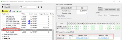

  2. Configure CMPA and CFPA to Default State
    • Open the SPT Tool, create a new workspace, and select the corresponding chip. Configure as follows:
  1. Program CMPA and CFPA
    • OK -> Build image, Write image, to burn the configured default CMPA and CFPA into the MCU.

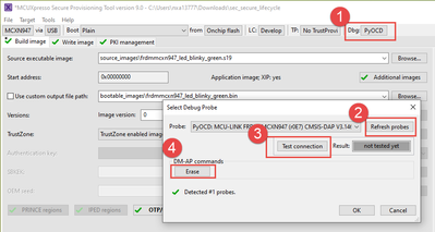

  2. Erase Entire Flash
    • Connect the board's debugging interface MCU-link via USB. Select the debug probe in the SPT Tool. After a successful connection, use Erase to erase the entire flash.
  • The chip is restored to its default state with no enabled security configurations.

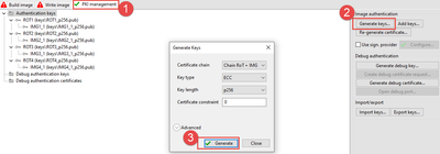

  1. Generate Secure Boot Keys
  • Select the PKI management interface -> Generate Keys... -> Generate

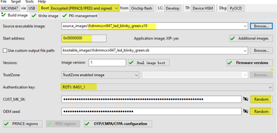

  1. Configure Image File
  • Open the "Build image" interface and configure as follows:
    • Boot: Select Encrypted (PRINCE/IPED) and signed
    • Source executable image: Select the application image file frdmmcxn947_led_blinky_green.s19
    • Start address: 0x00000000
    • Firmware version: 1
    • Authentication key: Choose any one of the 4 options
    • CUST_MK_SK: Click Random to generate a random number
    • OEM seed: Click Random to generate a random number

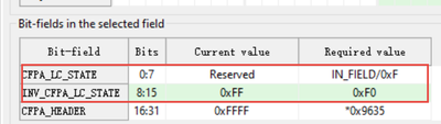

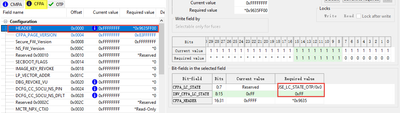

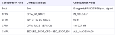

  1. Configure CMPA and CFPA
    • Open CMPA and CFPA, and configure to enable security:
  1. Generate Configuration Files and Image File
  • After configuration, build the image to generate CMPA, CFPA configuration files, and the SB3-formatted image file.

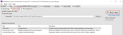

3.2.3 Program Application
  1. Program Configuration Files and Image File
    • Open the "Write image" window, click "Write image" to program the configuration files and the SB image file.

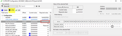

  • Compile the SDK example frdmmcxn947_led_blinky to generate a .bin file or s19 file. For all supported formats by the SPT tool, refer to the SPT manual. Here, use the s19 file format frdmmcxn947_led_blinky_red.s19.
  • Open the SPT tool and use the workspace created for the first application image file. This will import the necessary keys directly. Then, import frdmmcxn947_led_blinky_red.s19.
  • The Image firmware version should be greater than 0. Since we have not configured Set minimal firmware version, the minimum version is 0. This involves the anti-rollback feature, which will be explained in detail later.

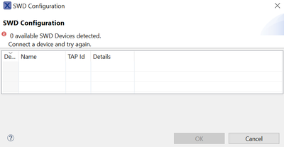

3.2.5 Verify Security Features
After enabling secure boot and configuring the lifecycle for field mode, the MCU cannot read the flash via SWD or ISP, ensuring the security of the customer's code against theft and tampering. To test if the configuration is successful, you can use the SWD and ISP interfaces. You should find that the SWD interface cannot connect, and while the ISP interface can connect, it cannot read or write. Note that before testing, you need to hold the ISP key and perform a software reset (not a power-on reset).
