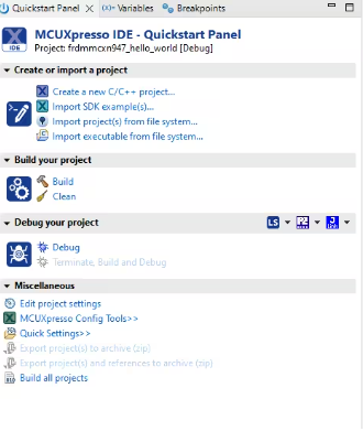

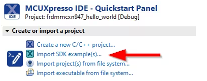

  1. Find the Quickstart Panel in the lower left-hand corner.
  2. Then click on Import SDK example(s).Sabina_Bruce_2-1767118904196.pngSabina_Bruce_2-1767118904196.png

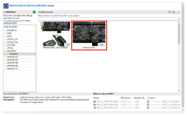

  3. Click on the board you are using to select an example that can run on that board, and then click on Next.

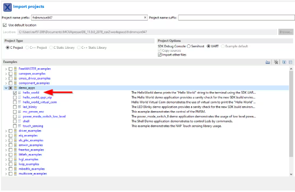

  4. Use the arrow button to expand the demo_apps category, and then click the checkbox next to hello_world to select that project. To use the UART for printing (instead of the default semihosting), select UART as the SDK Debug Console checkbox under the project options. Then, click on Finish

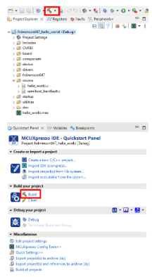

  5. Select the project and build it by either clicking on the “build icon” in the shortcuts provided above or by clicking “Build” in the Quickstart Panel
  6. The project should build without presenting any errors or warnings in the console

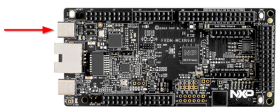

  7. Connect the board to your computer with the type-C USB cable to ‘MCU-LINK’ port. Check your board's user manual for instructions.

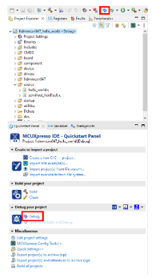

  8. Download the application to your board by either clicking on the “debug” icon above or clicking on “Debug” in the Quickstart Panel

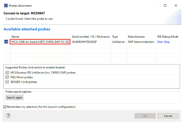

  9. Select the MCU-Link CMSIS-DAP debug probe

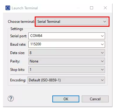

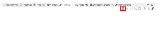

  10.  Open up a serial terminal to be able to see the application’s output. Select the “Terminal” window and press the “new terminal” icon
  11. Choose a “Serial Terminal” and then set the UART settings to 115200 baudrate, 8 bit data size, no parity and 1 stop bit. Press OK

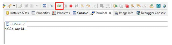

  12. Run the application by pressing the “run” icon. See the output printed on the terminal
