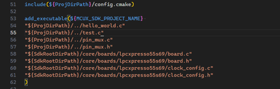

Hello, I try to use VS Code to develop MCU project. If I create some folder to store the source file(*.c and *.h), how to add the path setting in VS Code?
And how to modify the "Optimization" level?

Hello @Lurkersoo
Please refer to blow steps from my colleague:
To add a file to the project, the user will need to create the file in VSCode, then add the file path to the CMakeLists.txt manually:
Open the armgcc/CMakeLists.txt then navigate to "add_executable" command:
Then add your files shown above.
To add include directories to the project, add the path to the "target_include_directories" command:
To change the optimization level, open the armgcc/flags.cmake and edit all compiler flags accordingly:
The default optimization level for Debug build is -O0, and -Os for release build.
