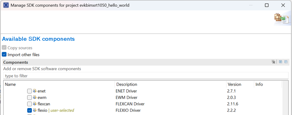

In MCUXpresso, if I would like to add additional peripheral drivers to a project, I can right-click on the project in the Project Explorer, and choose SDK Management > Manage SDK Components. When I choose to add a driver, the associated ".c" and ".h" files get added to the drivers folder in the Project. Now the defines, typedefs, and function signatures and definitions associated with a peripheral are browsable and usable.

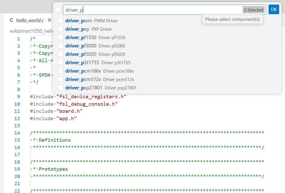

In VS Code, if I choose Configure > Manage Components and check a box for a driver, it gets added to the config.cmake file with a set(CONFIG_USE_driver_<peripheral> true) entry, but the source code is not added to the project directory. This makes browsing (and therefore using) the driver code much more challenging.
Am I missing something here about adding drivers to a project?

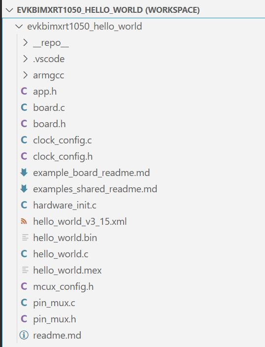

Attached is a project that I created with "Import Example from Repository". I started with the hello_world exampled. After the import, I tried to add the flexio and pit drivers with `Configure > Manage Components`.
They show up in the config.cmake file:
set(CONFIG_USE_driver_flexio true)
set(CONFIG_USE_driver_pit true)

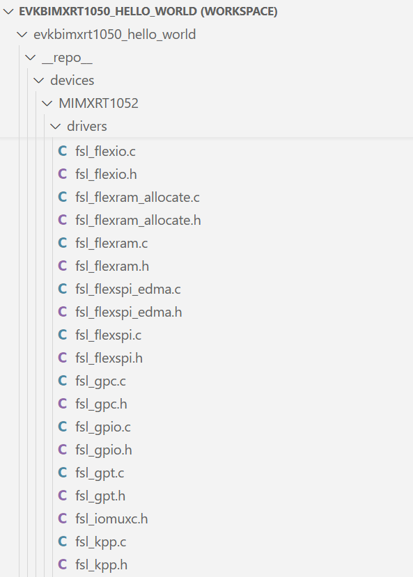

But the pit and flexio headers (.h) and source (.c) files are nowhere to be found in my Project folders:
Unless I dig into the __repo__ folder (where all of the drivers are included)
Furthermore, if I revisit `Configure > Manage Components`, the pit and flexio drivers are now simply not listed, instead of being listed with a checkbox next to them, which is what I would expect.

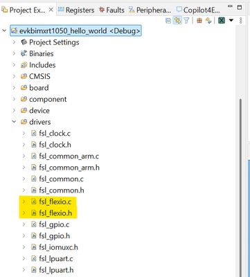

I am used to being able to easily see which drivers are included in an MCUXpresso project in the "Manage SDK components" dialog
and then having the source code appear in the drivers folder:
It's painful if VSCode does not make the source code browsable and viewable like this.

The idea behind MCUXpresso with VSCode was to avoid having multiple projects with the same files. That’s why only the .obj and .su files were included.
That said, I’ll share your feedback with the internal team. If you encounter any other concerns, feel free to share them in the community.
