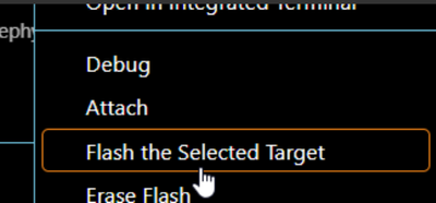

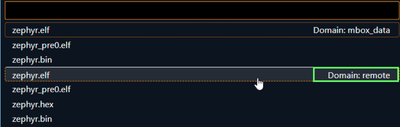

I tested it again. I believe that the CPU1 doesn't get programmed when just pressing the debug button from VSCode. So my steps are:
1. Flash the CPU1 (remote domain)
2. Then I can debug the application:
I'm able to replicate this each time. Can you please check again?

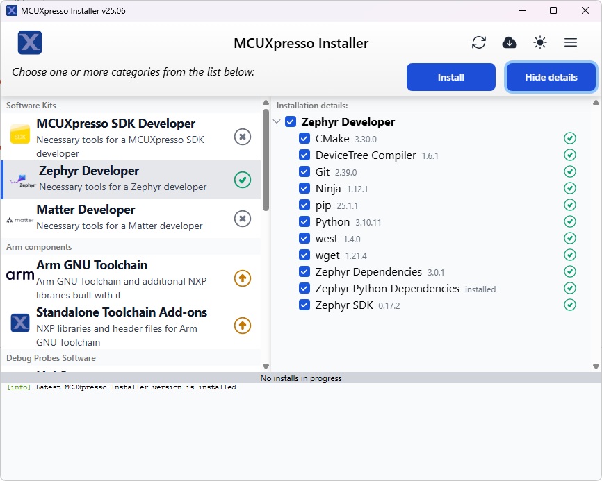

Hi @Jorini
Sorry,  i updated the SDK used in the zephyr environment to 0.17.2 and it is working now. Can you please try updating and testing again?
Harry
5,432件の閲覧回数
Jorini
Hi @Harry_Zhang ,
I've updated what you told me, and it still behaves the same. I'm attaching a screenshot of the project import and the error message it displays when debugging the project. I'm also attaching the installed versions.

Harry_Zhang
Hi @Jorini
Harry
4,713件の閲覧回数
Jorini
Hi @Harry_Zhang , following the steps indicated works correctly. In other projects, the code is automatically loaded into memory, but in these, I see that it isn't. Thanks for your help.
