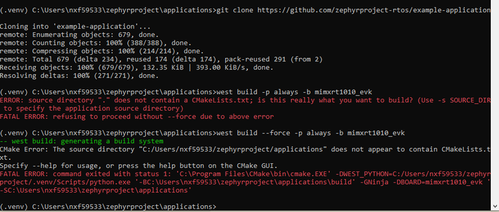

Then I tried to  import the https://github.com/zephyrproject-rtos/example-application and created applications folder at  zephyrproject\applications. I used the:
  git clone https://github.com/zephyrproject-rtos/example-application,
 I obtained the below errors when running west build, yet I do not know yet how to solve them, so I could not reproduce the issue you are getting.

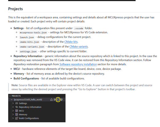

According to the MCUXpresso VS code wiki,  those are the settings that VS code expect from a project.
We have an example project, that you could use to test and compared for missing files
https://github.com/wolfSSL/nxp-appcodehub/blob/main/dm-wolfssh-rgb-server-with-zephyr/README.md
You could try to diff check both examples, and try to follow your procedure (git clone into  zephyrproject\applications) to test with a sample project we expect to work under our VS code.

Thanks for your reply Diego!
Firstly, as I mentioned, it was necessary to modify at least app/prj.conf and app/src/main.c to make a project that will compile.
Simplest option is to use what is in the "hello world" sample: for app/prj.conf use
# nothing here!
and for app/srsc/main.c use
#include <stdio.h>
int main(void)
  printf("Hello World! %s\n", CONFIG_BOARD_TARGET);
  return 0;
Next, before running the west build command, cd to the directory that you cloned. In your case, since you didn't specify a directory name, the directory is called example-application.
Then, specify the app directory as what is to be compiled.
So, if your board's name is mimxrt1010_evk, the command is:
west build --force -p always -b mimxrt1010_evk app
Secondly, thanks for the wiki hint! I missed the .vscode directory; should have looked for hidden files!
I tried working through the README you listed, this command
git clone https://github.com/wolfSSL/nxp-appcodehub.git ssh-rgb
got me a setup.sh which I think is the one referenced in
https://github.com/wolfSSL/nxp-appcodehub/blob/main/README.md
although there is no nxp-appcodehub directory.
(.venv) test@zephyr-vm:~/zephyrproject/applications/ssh-rgb$ ./setup.sh dm-wolfssl-tls-hello-server-with-zephyr
Created .vscode directory in dm-wolfssl-tls-hello-server-with-zephyr.
cmake-kits.json created.
cmake-variants.json created.
launch.json created.
mcuxpresso-tools.json created.
settings.json created.
As I mentioned, I was able to import a couple of the zephyr sample projects into VSCode -- "Import Example from Repository" works, it's "Import Project" that I have a problem with -- so I do have a couple of VSCode projects. So I was able to copy a .vscode directory with
launch.json mcuxpresso-tools.json settings.json tasks.json
But there was no sign of a cmake-kits.json or cmake-variants.json anywhere in my home directory so I added the files from your script.
Now the Import Project seems to be working!
