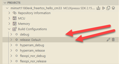

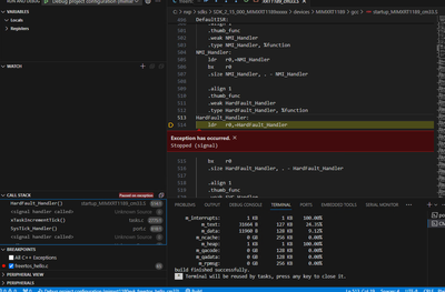

I imported rtos hello world demo app in vscode and when debugging, it hits a hardfault as shown in screenshot.
SDK-2.15, EVK- RT1189B0 , example app: freertos_hello_cm33. Linkserver v3.122. EVK SW5 0100
I'm not sure i'm seeing this same error as in https://community.nxp.com/t5/Cognex-i-MX8M-NOTE-Shared-with/Putting-heap-in-SRAM-OC1-leads-to-HardFa...
If it is VScode i'm not sure how edit the config variables.

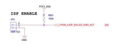

Set the on-board debugger to ISP mode. By closing asserting the ISP pin of the LPC55s69, then doing a power cycle. On RevC2 board, this is the related jumper

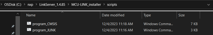

After installing the new LinkServer.exe, please navigate to C:\nxp\LinkServer_1.4.85\MCU-LINK_installer\scripts. Run any of the below scripts, them remove the ISP jumper of the LPC55s69. If you are still experiencing issues with LinkServer, please test with J-Link.
Please try again to do a mass erase to the flash, and if you are still getting issues, let me know. We could do a mass erase over UART/USB using MCUXpresso Secure Provisioning Tool.

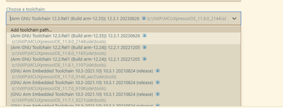

- The toolchain you used to compile the demo

Toolchain is ../.mcuxpressotools/arm-gnu-toolchain-12.3.rel1-mingw-w64-i686-arm-none-eabi"

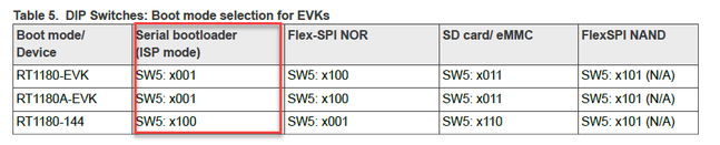

@arunkumar_g , here is an update.  Please set the RT1180 into serial downloader mode and do a power cycle. The attempt  to do a mass erase again using LinkServer/SWD.
Please let me know your results.
I hope this could help you.

Thanks, I changed the switch to 0001 and repeated the same using linkserver flash programmer.
Here is the output - different than earlier, but still reported failure

Nc: ROM 1 E0002000: CID B105900D PID 04000BBD21 CSt ARM FPBv2 type 0x0 Misc - Undefined
Nc: ROM 1 E0000000: CID B105900D PID 04000BBD21 CSt ARM ITMv2 type 0x43 Trace Source - Bus
Nc: ROM 1 E0041000: CID B105900D PID 04002BBD21 CSt ARM ETMv4.0 type 0x13 Trace Source - Core
Nc: ROM 1 E0042000: CID B105900D PID 04000BBD21 CSt ARM CTIv2 type 0x14 Debug Control - Trigger, e.g. ECT
Nc: NXP: MIMXRT1189xxxxx
Nc: Inspected v.2 External Flash Device on SPI using SFDP JEDEC ID MIMXRT1180_SFDP_FlexSPI1_A_QSPI.cfx
Nc: Image 'iMXRT1180_SFDP_FlexSPI1_A_QSPI Dec 12 2023 17:27:31'
Nc: Opening flash driver MIMXRT1180_SFDP_FlexSPI1_A_QSPI.cfx
Nc: VECTRESET requested, but not supported on ARMv8-M CPUs. Using SOFTRESET instead.
Nc: Using SOFT reset to run the flash driver
Nc: AFTER driver startup timeout (302 5ms retries)
Wc: Driver Addresses
Wc:  Start:  20000000
Wc:  Entry:  2000009D
Wc:  End:    2000074C
Wc:  Stack:  20002750
Wc:  Mailbox:2000A750
Wc: Driver Register State
Wc:  R0:     525E0000
Wc:  R1:     00000008
Wc:  R2:     20000490
Wc:  R3:     00000001
Wc:  R4:     00000002
Wc:  R5:     00000000
Wc:  R6:     200004C4
Wc:  R7:     00000000
Wc:  R8:     00000000
Wc:  R9:     00000000
Wc:  R10:    00000000
Wc:  R11:    00000000
Wc:  R12:    00000004
Wc:  SP:     20002700
Wc:  LR:     20000285
Wc:  PC:     10008F20
Wc:  xPSR:   69000000
Wc:  MSP:    20002700
Wc:  PSP:    20002750
Wc:  CFBP:   00000001 (CONTROL=0x0, FAULTMASK=0x0, BASEPRI=0x0, PRIMASK=0x1)
Nc: Flash Driver V.2 startup failed - rc Ef(34): Timed-out initializing flash.
Ec: vendor chip initialization failed - Ef(34): Timed-out initializing flash.
Wc: failed to initialize flash driver MIMXRT1180_SFDP_FlexSPI1_A_QSPI.cfx
Nc: Inspected v.2 External Flash Device on SPI using SFDP JEDEC ID MIMXRT1180_SFDP_FlexSPI1_A_QSPI_S.cfx
Nc: Image 'iMXRT1180_SFDP_FlexSPI1_A_QSPI (Secure) Dec 12 2023 17:28:24'
Nc: Opening flash driver MIMXRT1180_SFDP_FlexSPI1_A_QSPI_S.cfx
Wc:  Start:  20000000
Wc:  Entry:  2000009D
Wc:  End:    2000074C
Wc:  Stack:  20002750
Wc:  R0:     525E0000
Wc:  R1:     00000008
Wc:  R2:     20000490
Wc:  R3:     00000001
Wc:  R4:     00000002
Wc:  R5:     00000000
Wc:  R6:     200004C4
Wc:  R7:     00000000
Wc:  R8:     00000000
Wc:  R9:     00000000
Wc:  R10:    00000000
Wc:  R11:    00000000
Wc:  R12:    00000004
Wc:  SP:     20002700
Wc:  LR:     20000285
Wc:  PC:     10008F20
Wc:  xPSR:   69000000
Wc:  MSP:    20002700
Wc:  PSP:    20002750
Wc: failed to initialize flash driver MIMXRT1180_SFDP_FlexSPI1_A_QSPI_S.cfx
Pc: ( 65) Chip Setup Complete
Pc: (100) Target Operation Failed
INFO: Exact match for MIMXRT1189xxxxx:MIMXRT1180-EVK found
INFO: Selected device MIMXRT1189xxxxx:MIMXRT1180-EVK
INFO: Getting available probes
INFO: Selecting probe by serial substring
INFO: Selected probe #1 FKEE1042ZRODR (MCU-LINK on-board (r0E2) CMSIS-DAP V3.122)
INFO: MCU-Link firmware update check: local firmware [3.133] can be programmed on the selected probe ([FKEE1042ZRODR] [MCU-LINK on-board (r0E2) CMSIS-DAP V3.122])
CRITICAL: Critical error
ERRMSG: subprocess.CalledProcessError: Command '['c:\\NXP\\LinkServer_1.4.85\\binaries\\crt_emu_cm_redlink.exe', '--redlink-port', '11111', '--flash-dir', 'c:\\NXP\\LinkServer_1.4.85\\binaries\\Flash', '-x', 'C:\\Users\\agopinat\\AppData\\Local\\Temp\\tmp79v798pm', '-pMIMXRT1189xxxxx', '--vendor', 'NXP', '-g', '--cache', 'dis', '--probeserial', 'FKEE1042ZRODR', '--coreindex', '3', '--no-packed', '--dapstride', 'short', '--connectscript', 'RT1180_connect_M33_wake_M7.scp', '--flash-mass-load-exec', 'C:\\nxp\\src\\demo\\mimxrt1180evk_freertos_hello_cm33_1\\armgcc\\debug\\freertos_hello_cm33.elf']' returned non-zero exit status 1.

diego_charles
Hi @arunkumar_g
From the log, I can see that the on-board debugger ( MCU-Link ) is not running the latest version available.
You can update the on-board debugger as well.
Download and install the latest version of LinkServer  https://www.nxp.com/lgfiles/updates/mcuxpresso/LinkServer_1.4.85.exe
Diego
8,658 次查看
arunkumar_g
OK I updated firmware to 3.133, did a mass erase via mcuxpresso ide and now vscode debug works without segfault. Thanks for the help.
8,654 次查看
diego_charles
Glad to know that this solved the issue, thank you.

Hi @arunkumar_g
Unfortunately, I can not access to the community space your are pointing to.
Currently, I still do not have this board in my office, but let me check how can replicate this, asking another colleague.
Still, I want to know if you get any different result by trying to change build configuration for the project.
Thanks a lot!
