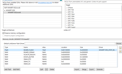

The default address of the flash on the board is 0x60000000, but I want to debug my afx file at 0x60100000. T
his is because my bootloader application is written at 0x60000000 and it takes too much time to rewrite it. Therefore, I want to change the address to 0x60100000 and proceed with the debugging process.
However, after changing the base address, writing is successful but debugging fails. Do I need to change the cfx(or scp) file or .ld file? There is no command for the .boot_hdr section in the generated .ld file.

As you can see in the above , JEDEC_SFDP_Device appears as 0x60000000 after the scp file. Please let me know how to proceed.

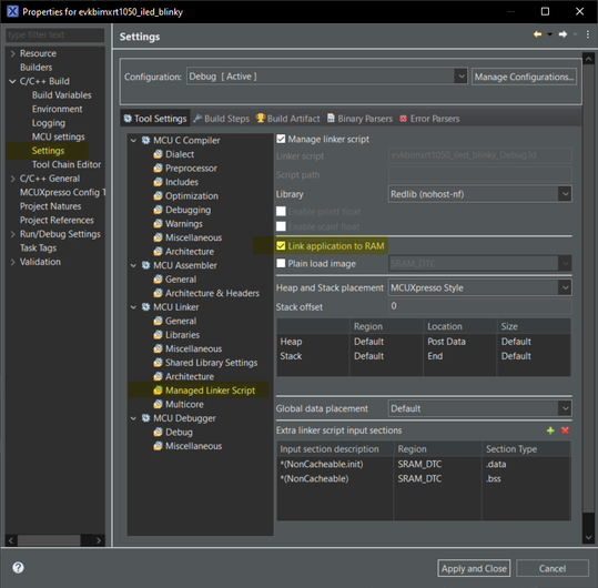

For debug purposes, I would link the application to RAM. This would be easy. Easiest method is linking to internal SRAM ( OCRAM, ITCM , DTCM). MCUXpresso does support this option and enables easy debug for this.

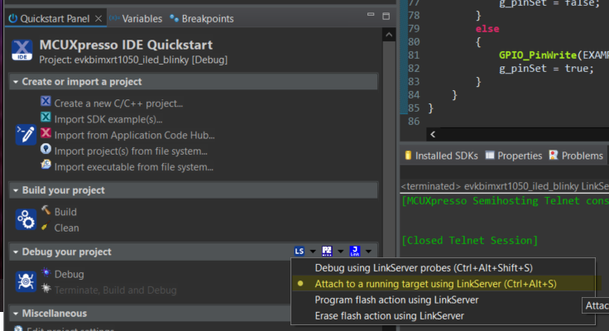

You can load your application at 0x6010_0000 let your bootloader to jump to the application and then manually  attach the debugger when the application is executing. MCUXpresso should let you do this. I understand that  you are using MCUXpresso when you mentioned about the scripts

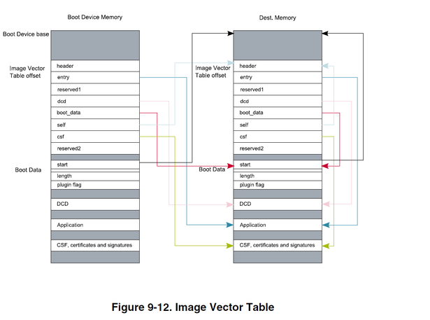

Now, if you really do not want to use the bootloader and debug the application at at 0x6010_0000. You need to  set the image start address of the Image Vector Table (IVT) to this area.
However, the IVT does need to always be placed at 0x6000_1000. The bootROM will always search the IVT at this address when attempting to boot XIP images. So, you may need to overwrite the bootloader space, in this scenario. This video introduces boot flow, IVT and other elements of bootable images shortly and nicely  NXP: MCU Tech Minutes: Boot Options for i.MX RT Crossover MCUs. If you want to follow this path, let me know, so I can give you more information.
