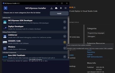

Which J-link software do you have installed on your setup?
Did you check application note AN14120?
Best regards.
2,838 Views
JorgeCas
Could you please try with mentioned on this post?
It seems that is an error caused by a bad installation.
