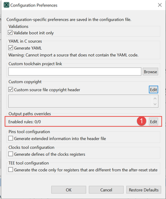

       I used MCUXpresso Config Tools v15, and I recommend you try again with the latest version. When we open MCUXpresso Config Tools through VS Code, click "Configure Preferences" under "Edit" in the toolbar, and the reference window is as follows:

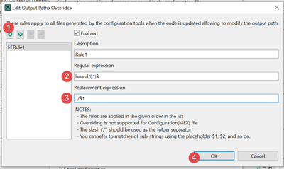

       Click Edit to enter the window, add new rules as follows:
      Once this is done, you can generate the code into the vs code project.

I followed your instructions and the errors are no longer there, thankyou
