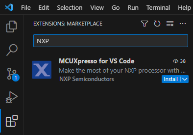

Extension Installation Steps
  • Launch Visual Studio Code
  • Click the Marketplace icon found in the main left navigation pane
  • Search "NXP" in Marketplace search bar.  Click "MCUXpresso for VS Code"
  • Click Install in the MCUXpresso for VS Code extension.  Installation includes other required extensions (i.e. C/C++ by Microsoft)

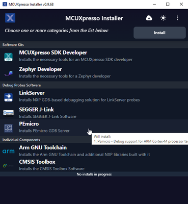

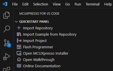

Dependency Installation Steps
  • Links for the MCUXpresso Installer are in Quickstart Panel added by Visual Studio Code extension.
  • Click Open MCUXpresso Installer
  • The Installer UI launches to assist in adding required software tools/settings.
  • Select from "Software Kits", "Debug Probes", and "Individual Components" appropriate for your development.
  • Click Install
  • NOTE: Installer can Check that you have the latest installer by clicking Cloud icon
Your system should now be ready to begin developing with NXP.  Please review included Walkthrough OR "Online Documentation" for further assistance.
