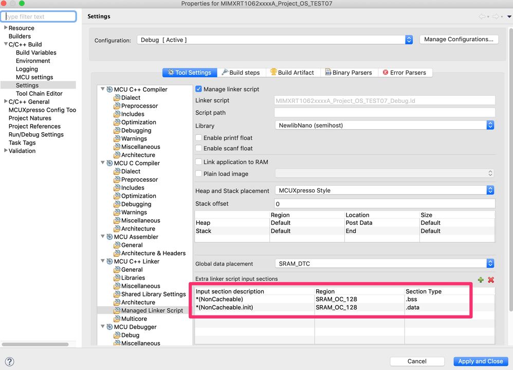

Hello,  I am getting an error for the Start Address when trying to generate a bootable image using the Provisioning Tool.
My project uses a section of OCRAM for a noncached DMA buffer location.
If I remove this section, the Start Address is correct.
How can I use the Provisioning Tool with this DMA buffer section?

addiyi
Hi Jack,
I took a look at the example attached and discovered two possible issues:
1. First one is about XIP_BOOT_HEADER_ENABLE preprocessor defined symbol which is set to 1 and must be set to 0. This version of SPT is not handle XIP_BOOT_HEADER_ENABLE=1;
2. Did you intentional set NonCacheable section as .bss? When NonCacheable section is set as .bss, then there is no relocation of the .data_RAM4 section from flash, because the size of this section is 0.
.data_RAM4 00000000 20240000 20240000 00030004 2**2
CONTENTS
Once NonCacheable section is placed in .data, relocation data is added and image can be loaded by SPT with no error.
.data_RAM4 00000c80 20240000 60005b64 00020000 2**5
CONTENTS, ALLOC, LOAD, DATA
Adrian

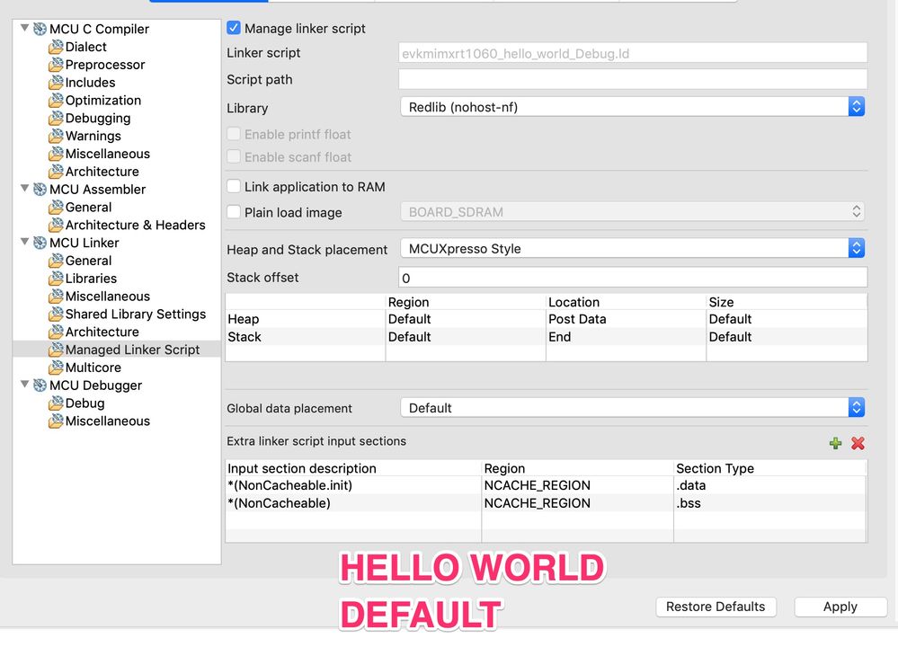

jackking
Senior Contributor I
Sure,  here is a simple example based on hello_world sample.
I added a DMA memory region and initialized a byte array in the DMA region.
I use an Embedded Artists EVK, so you would need to change the flash driver if you want to build it for the NXP EVK, but I included the Debug .axf file in the zip file.

addiyi
Hi Jack,
CONTENTS
Adrian

jackking
The XIP header was an error, as I created this project just to demonstrate the address error for you, not actually create a bootable image.
The NonCacheable setting is from the default settings in Hello World example.  All I did was change the memory region used.
After changing it to .data, the address is correct for SPT.  Thanks!
