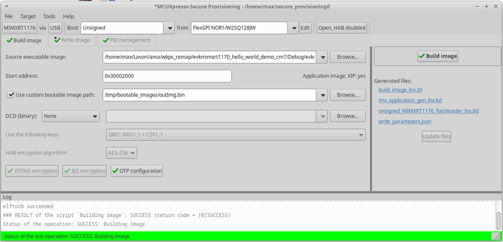

On the Build tab there's "Dual image boot" button offering configuration of the remap feature
here is the screenshot of the build tab, I can't see the "dual image boot" button. Can you point me to it?
For the rest: with SEC I cannot create an image that also contains FCB. It seems that it is built and written only by flashloader.
So I try to put the question in other terms:
with SEC and offline (no connection to any card), how do I create an image (plaintext or encrypted) that contains all the boot headers, including FCB and keyblob, so that I can write it to the flash using JLINK (and not with SEC itself)?

marek-trmac
Hi Max,
SEC tool usually write the parts separately and it is not configurable. SEC tool cannot generate all formats and all variants, what users want, so it generates one variant that can be customized (it is possible to modify build and write scripts manually).
Marek
