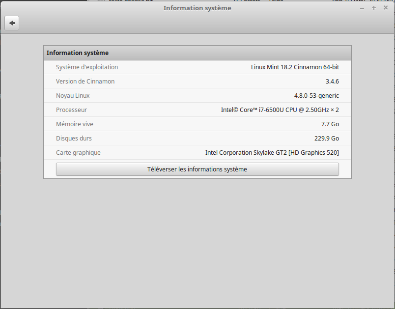

nada_lakhal
Hi Libor,
This is the system's information.
Nada
4,625 Views
liborukropec
according to Linux Mint 18.2 Cinnamon Release Notes - Linux Mint
Linux Mint 18.2 is based on Ubuntu 16.04.
It is quite outdated, this spring the LTS version of Ubuntu will be 20.04. The tool was tested on Ubuntu 18.04 LTS, and should work also on Ubuntu 19.x. I can look whether there's some workaround for Ubuntu 16.04 based distribution (I'll let you know later), but I highly recommend to use the tested and supported OS for Secure Provisioning tool.
