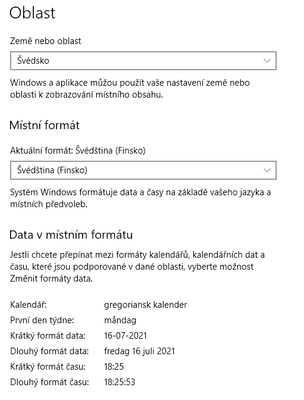

I have freshly installed Win10 Pro (English - Finland,Sweden...) computer and i'm trying to setup toolchain our toolchain.
Secure provisioning tool flashes the command box and then fails without possibility to read the command content. Using cmd to launch securep results the same behaviour.
=> running the cmd as administrator and running the securep gives:
C:\nxp\MCUX_Provi_v3\bin>securep
INFO: [root] workspace C:\Users\Ylitalo\secure_provisioning
INFO: [root] Loading settings from workspace: NO_SETTINGS
Traceback (most recent call last):
File "securep.py", line 64, in <module>
File "securep.py", line 36, in main
File "securep.py", line 59, in main_run
File "src\gui\main\main_win_ctrl.py", line 547, in run_gui
File "src\gui\main\main_win_ctrl.py", line 62, in __init__
File "src\gui\main\main_win_keys.py", line 82, in __init__
File "src\gui\main\main_win_build.py", line 50, in __init__
File "src\gui\main\main_win_write.py", line 45, in __init__
File "src\gui\main\main_win_core.py", line 53, in __init__
wx._core.wxAssertionError: C++ assertion "strcmp(setlocale(0, 0), "C") == 0" failed at ..\..\src\common\intl.cpp(1694) in wxLocale::GetInfo(): You probably called setlocale() directly instead of using wxLocale and now there is a mismatch between C/C++ and Windows locale.
Things are going to break, please only change locale by creating wxLocale objects to avoid this!
[11508] Failed to execute script securep

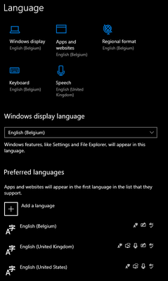

marek-trmac
Hi, could you please send screenshot of your settings from:
Windows - Settings - Time&Language - Region
and
Windows - Settings - Time&Language - Language
Marek
NOTE: If you find the answer useful, kindly click on [ACCEPT AS SOLUTION] button
12,382 Views
pdgendt
Hi Marek, here are the screenshots
12,373 Views
marek-trmac
Hi Pieter,
thank you very much for fast response. I can reproduce the problem now and it will be fixed in next version.
As a workaround, please select United States as Region and also Regional Format.
We are sorry for inconvenience.
Marek

marek-trmac
Hi Ylitalo,
updated: I have reproduced the issue today. It seems SPT does not start if regional format is not listed in https://docs.wxwidgets.org/3.1.4/language_8h.html
Workaround: select format from the list of supported languages.
We're sorry for inconvenience.
Marek

liborukropec
Hello Ylitalo,
it seems as known bug of 3rd party code (wxWidgets/Python) with self-explanation title "Avoid WX non-US locales issue on Windows" - https://github.com/xraypy/xraylarch/pull/306
I did my best, still I cannot reproduce, even tried combination different Regions and Locales. And the app still can be executed.
Could you please make screenshots when it does not work? Because there can be more combinations. I mean:
Settings | Time and Language - Region
- what is Region?
- what is Locale?
Settings | Time and Language - Language
- what is the System Language of windows
Thank you and regards,
Libor
