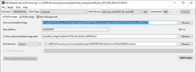

I am using MCUXpresso Secure Provisioning v 3.1.
I am compiling code to run from BOARD_SDRAM, but bootable image is intended to be stored un eMMC/SD.
The problem is that application binary in generated bootable image is always located at 0x00001000. regardless BOARD_SDRAM location in memory configuration (0x80001000 or 0x80003000 et.).
Is it possible to change this offset in final *.bin file? How to do that? Will RT1050 built-in Boot ROM be able to boot from such image (with different application offset than 0x1000)?
My intention is to use 2 secondary bootloaders (for safety) and after updating one of them to change IVT to point to other bootloader in bootable image. I am using 2 separate projects and the idea was to store both bootloaders in final *.bin (which will be 1:1 stored on eMMC/SD) in different loacations. Then RT1050 booting from eMMC or SD would pick up the one pointed to by IVT.

marek-trmac
Hi Arnisj,
please find in the PDF documentation, how to build the image for SDRAM:
- chapter 7.2.1.3 contains info how to build the source image
If you have EVK board, you can also use pre-compiled image located in c:\nxp\MCUX_Provi_v3.1\bin\data\targets\MIMXRT1050\source_images\evkbimxrt1050_iled_blinky_SDRAM.s19
Here is how the configuration should look line in the tool:
Hope this helps
The offset cannot be directly changed in SEC tool. However the bootable image is created via the build script so you can manually modify it (not recommended unless you are an expert).
Marek

arnisj
Hello, Marek!
If I do as you suggest, in generated file application code starts at 0x00001000 regardless SDRAM location is set to 0x80002000.
Look in image I attached. Is there a way to get application code start in image file at address 0x00002000 ?
