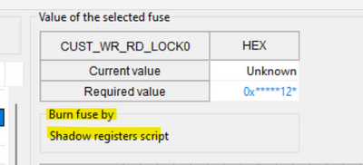

  2. On Build tab in the "OTP Configuration" configure the fuses. You can check if the fuse can be written into the shadow register:

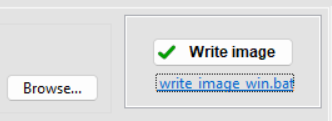

  3. Click on the "Build" button, it is required intermediate step

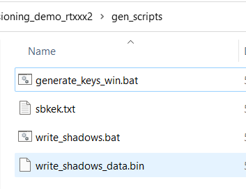

  4. Go to Write tab and click on the label "write_image_win.bat" (On Linux/Mac it will be *.sh).
    This will update all necessary files, including the write script and also the write_shadows.bat script that can be found in the gen_scripts\ folder
  5. double check the content of the script.
