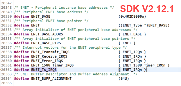

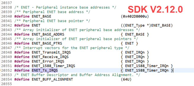

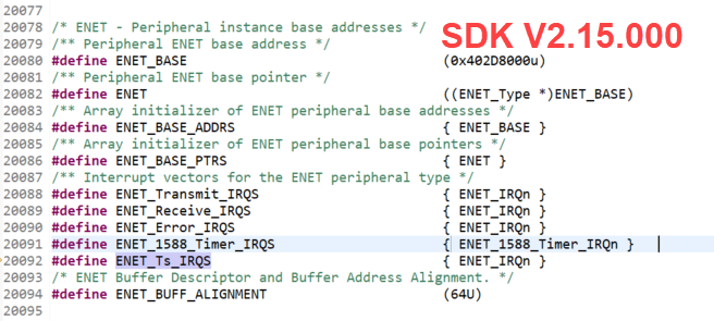

2,545 Views
mastupristi
Senior Contributor I
Hi @Hui_Ma
almost two years have passed this report. Now the SDK is at version 2.15.000.
However, that portion of the code I had indicated hasn't changed at all
https://github.com/nxp-mcuxpresso/mcux-sdk/blob/MCUX_2.10.0/drivers/enet/fsl_enet.c#L3556
https://github.com/nxp-mcuxpresso/mcux-sdk/blob/MCUX_2.15.000/drivers/enet/fsl_enet.c#L3171
That would disprove what you stated. By the way, the MCUX_2.12.1 release was never released
So you confirm that the bug is still there? If not, can you explain how it was corrected?
best regards
Max
2,514 Views
Hui_Ma
Hi Max,
I had posted software team feedback info about case: 00458118.
The macro definition of ENET_Ts_IRQS is incorrect at SDK V2.12.0.
That error definition was fixed at SDK V2.12.1.
Software team already fixed this macro definition issue at SDK V2.12.1.
Thanks for the attention.
Mike
