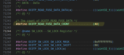

in file fsl_ocotp.c there is OCOTP_ReadFuseShadowRegisterExt()
at the beginning there is an assert to validate the `fuseWords` parameter. I tested that the assert is triggered for fuseWords >= 4
This is confirmed at line 71242 of MIMXRT1175_cm7.h

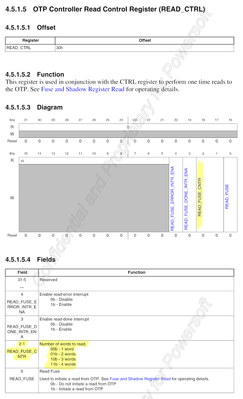

the RT1175 can read 4 words at a time on OCOTP. Therefore, the `fuseWords` parameter should be written OCOTP_READ_CTRL[READ_FUSE_CNTR]
in the source code, though, a field named READ_NUM is shown, which does not appear in any document or in any source related to RT1175.
I think this is a bug.

Hi @mastupristi ,
   Thank you for your interest in the NXP MIMXRT product, I would like to provide service for you.
I think your report item is reasonable which also consider the Number of words to read.
I report this SDK requirement to our SDK team, they will help to fix it in the new version.
Thanks a lot for your contribution.
