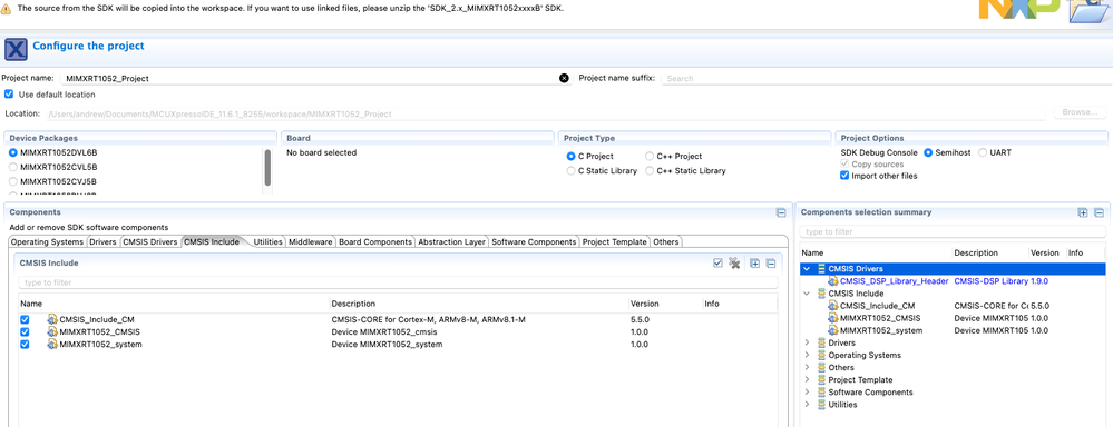

Coming back to this - to reproduce basic build problems w/ this SDK and ARM CMSIS DSP functions, start with a fresh project:
Screen Shot 2023-01-27 at 9.22.35 AM.pngScreen Shot 2023-01-27 at 9.22.46 AM.png

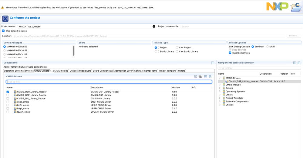

add in the CMSIS DSP library header... then verify what CMSIS components are included...

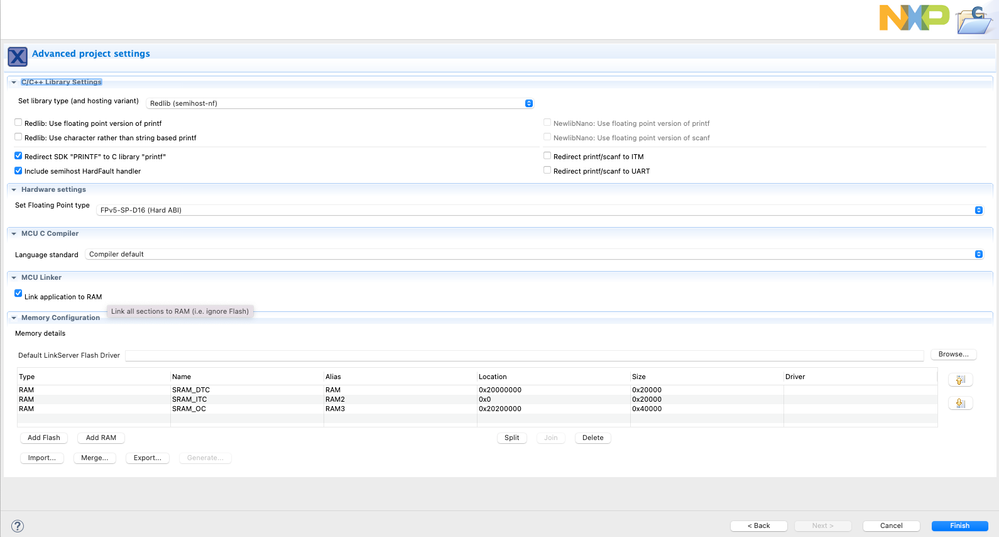

I linked the application to RAM to avoid messing w/ any FLASH setup, etc etc, then FINISH creating the project:Screen Shot 2023-01-27 at 9.25.08 AM.png

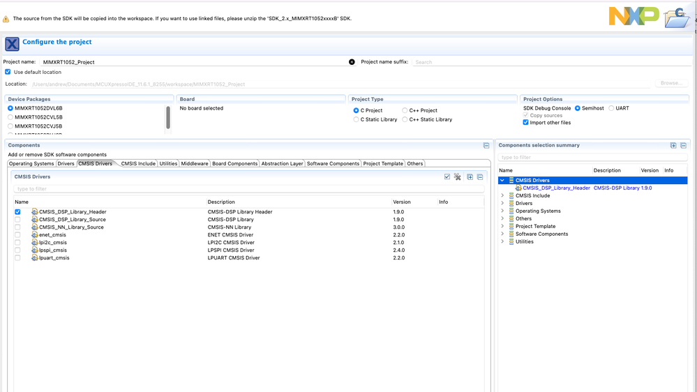

Then, try and build - see errors:
build fails despite includint arm_math.h which includes the specified matrix functionsbuild fails despite includint arm_math.h which includes the specified matrix functions
If i just include the library headers in the project and not the source, before this would include the actual .a file (the compiled library itself), but if you go to project settings, linker, library: the library is no where to be found.
no library anymoreno library anymore
