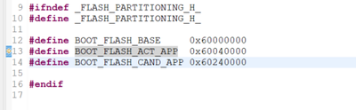

in mcux_config.h added:
#define CONFIG_UPDATEABLE_IMAGE_NUMBER 2
in flash_partition.h modified:
#define BOOT_FLASH_ACT_UPD              0x60040000
#define BOOT_FLASH_CAND_UPD             0x60140000
#define BOOT_FLASH_ACT_APP              0x60240000
#define BOOT_FLASH_CAND_APP             0x60340000
