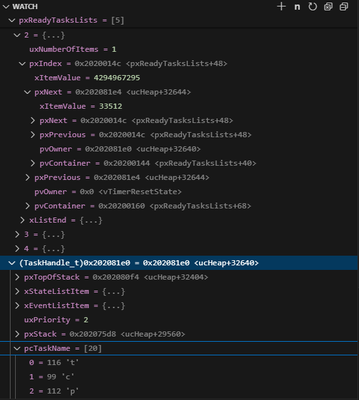

I'm getting FreeRTOS crash in the "wifi_setup" example imported from SDK.
Here's a tail of the debugging session output:

The debugger shows the state of the threads. The top of the current thread call stack is:
"Tmr Svc": Stopped
Reset_Handler@0x60002524
<signal handler called>@0xfffffffd
If I look at pxReadyTasksLists array in the debugger, it shows that its 2nd element has uxNumberOfItems == 1 but pxIndex points to xListEnd. At the same time, xListEnd->pxNext and pxPrevious point to "tcp/ip" task. I've attached a screenshot.

So there's nothing criminal there, just calling the original function. The crash happens after "In wrapper" is printed to the console, when the software should switch to "tcp/ip" task.
There's a similar post on FreeRTOS forum: https://forums.freertos.org/t/incorrect-pxreadytaskslists-state-causes-fault/17791, only in my case pxCurrentTCB is correct, pointing to "Tmr Svc" task.
The solution to that topic was an incorrect interrupt priority. I tried setting all NVIC->IPRn registers to 0xF0 at the beginning of the program to set all priorities to the lowest possible level but that didn't help. I also checked the stacks -- they are fine. I can attach my project or upload it anywhere if that helps.
If I don't use wrapper function, so that the SDK code calls tcpip_input directly, the example works but sometimes I get delays in ping responses of like 1600 ms which is strange because I ping my local router. So I suspect the bug is still there but adding a PRINTF makes it more apparent.

Have you tried building it in debug mode? I've found that the crash happens only in debug build. Also, setting
#define configTIMER_TASK_STACK_DEPTH (configMINIMAL_STACK_SIZE * 2)
fixes it in debug mode as well.
It appears stack overflow happens in timer task in debug mode. How do I calculate the amount of stack needed for the task?

azarubkin
For some reason, replacing tcpip_input with a simple wrapper leads to stack requirements growth in Tmr Svc thread.
4,099 次查看
