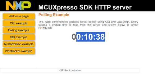

I am currently doing sanity test on my end with latest SDK. For now, I am limited to use my PC and the RT1060-EVK. I am using demo's timer and checking if the page re-loads.
Could you help me with more details regarding the failure? I guess that you are not longer seeing the timer updating or the web page responding.

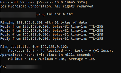

- After the demo stops working on your PC, do a ping to the demo. Check if there is any reply.
