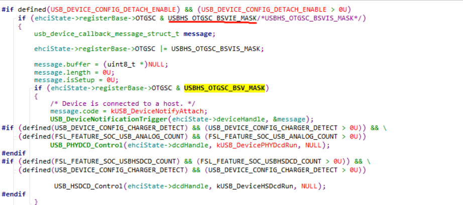

Hi:
        I try to get a notification when the USB decice disconnected from a host.
1. I modified the value of the macro definition USB_DEVICE_CONFIG_DETACH_ENABLE
/*! @brief Whether the device detached feature is enabled or not. */
#define USB_DEVICE_CONFIG_DETACH_ENABLE (1U)
2. Add  Event handler In callback function
But cannot detect the connection status.
when I modify the ehci driver  like shown as below , I can detect the device plug into a host , and can't detect unplug from the host yet.
So how to get a notification when the USB decice disconnected from a host.

Hi @bobhi009 ,
Did you menage to solve this issue??
@jingpan
The thing is that USB_DeviceEhciIsrFunction(...) function is not even triggered when USB is detached...

Hi @bobhi009 ,
I follow you step on my RT1060 EVK. It works well. Attach and Detach information is printed on UART.  I test on the USB CDC demo.
Jing

bobhi009
Thanks for your replay,
Did you modify the echi driver  like this?
2,614 Views
jingpan
No, I didn't change here.
