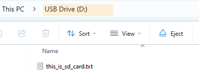

Hi — I’m running the MCUXpresso SDK sample dev_msc_disk_freertos on an i.MX RT1040 EVK.
- Windows shows a U-Disk with capacity equal to the board flash, even when I insert an SD card.
- I want the MSC to expose the inserted SD card (FAT32).
Thanks — seeking step-by-step to map MSC to SD driver.

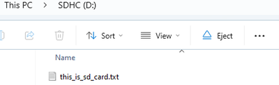

Hi @sudarshanhalse ,
I tested with RT1050-EVKB & dev_msc_disk_freertos demo in SDK for you. And it showed the inserted SD card memory. My local SDK version is 25.06.00. You can try it first.
Gavin
