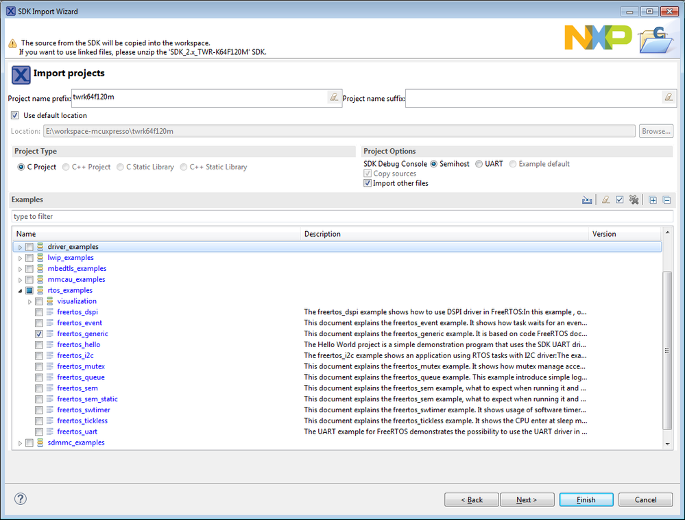

“freertos_generic” example under “rtos_examples” category in FRDM k64F SDK
2,255 Views
trialaccount12
Contributor V
     I am trying to import the “freertos_generic” example under the “rtos_examples” category in FRDM k64F SDK. But I could not see any "rtos_examples" or “freertos_generic” examples in my SDK. I used the MCU Xpresso SDK builder.  Demo applications and driver applications are existing. Can anyone point out where I could download the above example?
SDK version 2.6.0 and the document I follow states that it is present in SDK revision 2.4.0 . Does it mean it was removed?
Niranjan
Tags (2)
2,184 Views
danielchen
Hi  Niranjan :
Please download SDK 2.7 from below link
Welcome | MCUXpresso SDK Builder
Make sure freertos component is selected, or you can select all components
Then you will find the freertos_demo
