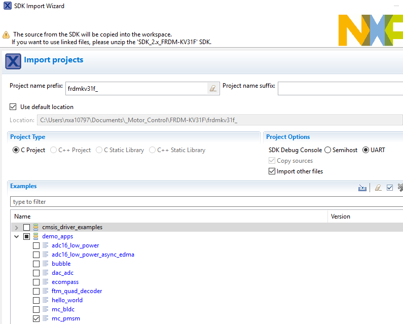

1)  Unfortunately there was no UART support built into this project.  If I were you I would look at the project Hello World and copy what they did for the UART. Or Option 2 (MCRSP_PMSM_V1.2.0) below which has full freemaster interface control built in.
So When you create the hello_world project in MCUXpresso IDE check the UART in the SDK Debug Console?

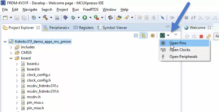

2) As you tried, use the Pins Config Tool to change the pins to be used for the UART both TX and RX. Soon there will be a peripheral tool that will aid you to do all of the setup for the various peripherals.

Then definitely look at and duplicate the UART set up in hello world or other UART SDK demo code, coping it to the motor project.
Philip
