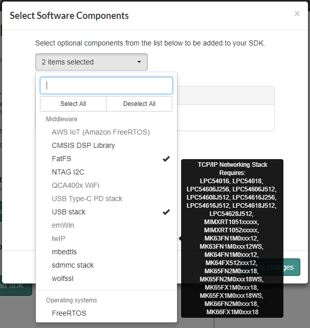

Does the TCP/IP stack included with the SDK for the K82 support IPV6 FreeRTOS?

Hello Lorna Jones,
The K82 SDK doesn't come with lwIP TCP/IP stack. It is only available for the following devices:
The lwIP stack does support IPv6. It can be enabled by defining the macro LWIP_IPV6 to 1.
Gerardo
