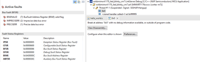

I borrowed a MIMXRT1170-EVK from a friend and, first of all, I wanted to make sure the basic demo applications are working. While I managed to run "hello_world_demo_cm4" and "new_project_cm4" without any issue, I could not make new_project_cm7 or hello_world_cm7 or iled_blinky_cm7 work. I get a seemingly successful build and load, but then something crashes and I get the following:
As this is my first contact with ARM cores, I had not changed a single line of code. What could be happening here?
Thanks!

We are investigating your problem; however we would need more information about the marking code of the chip. For making things simpler, could you please send us a photo of the chip? Also, let us know the schematic revision of your board.
Today I did a sanity test on the demo evkbmimxrt1170_iled_blinky_cm7 using MCUXpresso24.9 and SDK 16.100 and all works as expected, could you please tell me which MCUXpresso and SDK versions are you using?

First of all, I did not notice there is a difference between "EVK" and "EVKB"... sorry! My board is a MIMXRT1170-EVK but I was using an SDK from EVKB. I do not know the difference between these boards but, while CM4 examples work for both, CM7 EVKB blinky LED did not. The EVK blinky LED example worked fine after I got the correct SDK.
Just to be sure I am now doing things correctly: is it normal for D34 to be fixed red when I turn the board switch on and D5 to blink quickly when I am running the debugger (blinking stops when I pause the debug session)?

I'm glad to hear that you manage to solve the issue.
If you are interest in the difference between RT1170 EVK and RT1170 EVKB you can take a look to MIMXRT1170 EVKB Board Hardware User Guide chapter 6 Key differences between EVK and EVKB
About the behavior you mention, it is completely normal, the D5 is from the debugger and the D34 is a user led that in the reset is set with a pull-up.
