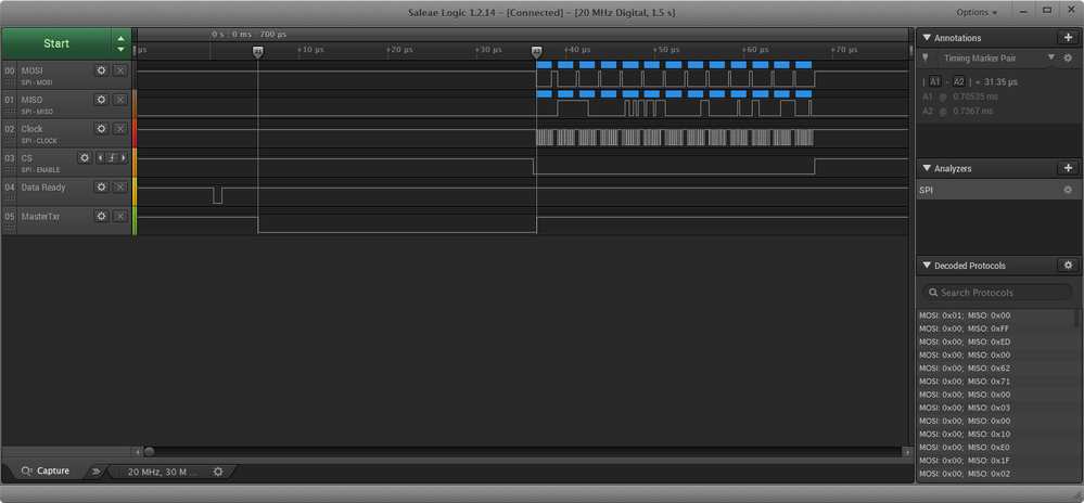

The part that I want to improve on it to have my data ready signal trigger the DMA transfer.  The current code has the GPIO interrupt calling the DSPI_MasterTransferEDMA() API.  When I measure this code I find that it's taking more than 31uS to complete.
How do I reduce this time?
5,373 Views
jorge_a_vazquez
Hi Terry Biberdorf
First of all, I would like to clarify that the latency that you get in your code isn't due to the interruption of the GPIO, so it will not help to change the GPIO part to trigger a DMA request; you cannot trigger SPI transfer with a GPIO DMA requests.
As I can see in your code, the biggest time-consuming part is inside DSPI_MasterTransferEDMA() API, it has to prepare all the DMA and SPI setup to start SPI transfers.

We still are looking for the correct method to reduce this delay between the interruption and the start of the transmissions.
We have found the root cause of the problem, edma driver needs to reload tcd to restart the transmission , this is the part where most of the time is spent  when using the StartTransmission API.
We are currently looking for the most appropriate way to change this; will continue investigating and performing some tests and we will update you as soon as we discover something.

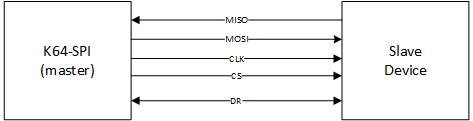

Can someone provide an MCXpresso API SDK example of SPI transfer with eDMA what will continue to cycle from a GPIO trigger?
So what I'm attempting to do is develop a SPI communicate interface that after the slave device is initialized, the slave device will continue to trigger DR (Data Ready) pulses to indicate that data is ready to be read.  I would like to have my K64 read this pulse event from a GPIO Interrupt. I would like to have the K64 eDMA transfer the data from the slave device on each of these IRQ events.
My working github code example listed above has this working with interrupt handling.  I would like to have it operate from eDMA to reduce the overhead.

Now, I have checked your application, if you require a SPI data transfer, then you need a peripheral to memory transfer type, and manage the request by SPI RX. Still you don't need to implement scatter gatter feature. let me explain.
Your will generate DataReady signals at a periodic time, this signal have to inform your K64 that it has to start transfer data, so K64 has to start the communication, and just until data has arrived to SPI data buffer (SPIx_RXFRn), your SPI will generate a RX FIFO drain request that will trigger DMA, and this will transfer data from SPI data buffer to internal memory (so kEDMA_PeripheralToMemory).
This implementation is already in the fsl_edma_spi driver, which you can see in the dspi_edma_b2b_transfer_master example. The only part here that you need to implement is to manage the DataReady signal, but this signal can be managed as a GPIO interrupt and inside the handler, put a Master Start transfer.
