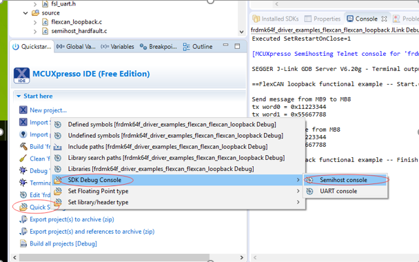

I've noticed that the PRINTF message to debug console do not work in some examples: eg.
demo_apps_dac_adc - debug console works fine
driver_examples_flexcan_loopback - debug console messages don't appear
Looking at the code and port numbers, everything looks the same. Any ideas why the debug console does not work for some examples? Is it a problem with MCUXpresso? Any ideas?

Which board you used ? I test on FRDM-K64 board, it can work well :
And please pay attention ,choosing " Semihost console" is print to Console, "UART console" is
print to UART .
Hope it helps,
