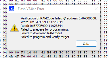

I flashed my custom board with a chip LPC55S69 with code example from nxp SDK using MCUXpresso IDE, example was trustzone hello_world, when i start debugging the board hang and from that time i can't flash it or erase it anymore.
i am using J-Link for debugging.
the message received from J-Link when trying to flash or erase is:
658 Views
mashraf
this solved by erasing the chip using ISP mode.
