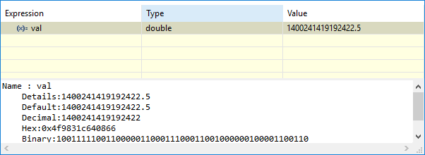

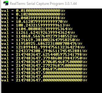

I'm trying to print a double value greater than 2147483647 but the output is always display 2147483647.0000000000 on the terminal. Can someone helps me to solve this issue?
This is my code:
The results are:
From the debug window I can see the value val is greater than 2147483647.

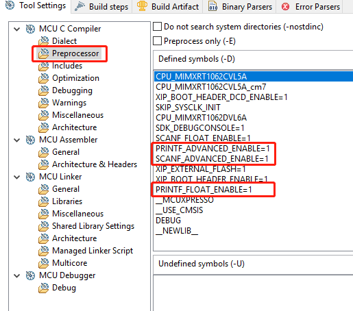

I've done these settings so far but still no luck.

The debug console is implemented with variables of 32 bits,  so in a low-level driver, it uses a "float to string" converter, this converter work with int32_t variables (0x7FFF_FFFF or 2147483647), this why the actual value is truncated.
You can go to the ConvertFloatRadixNumToString in the fsl_str.c file and change a,b,c, and uc to be int64_t variables (please note that the casting also has to change).
