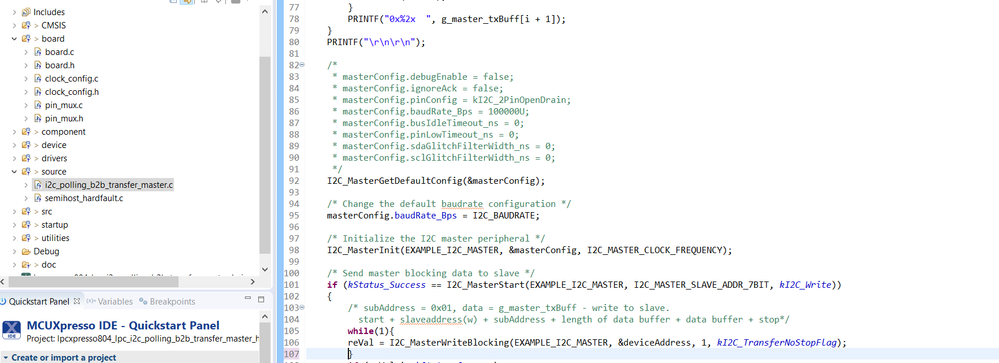

I'm doing a project that includes I2C communication with an LPC804 as master. I'm using the breakout board "LPCXpresso804 board". I started out with an example code from the SDK to MCUXpresso called "lpc_i2c_polling_b2b_master_transfer" to get an idea about what I need to have get I2C to work. The example chooses pin "P0_14" as SCL and "P0_7" as SDA.
Nevertheless, when I run the example code I can not measure any clock-like signals on the SCL line, and nothing at all on the SDA line.
Any ideas as why this can be? Is there something I have to set up that I didnt see in the example?
I put a while(1) loop in there to make the MCU keep sending the same message over and over again, so the problem is not simply that I started measuring after the I2C communication happened. I'll upload a picture from the main loop.Udklip.PNG

Hello  Martin Busk Rasmussen ,
Have you connect the I2C slave board?  Master need get ACK from slave.
You can refer to the readme.txt under project to connect .
