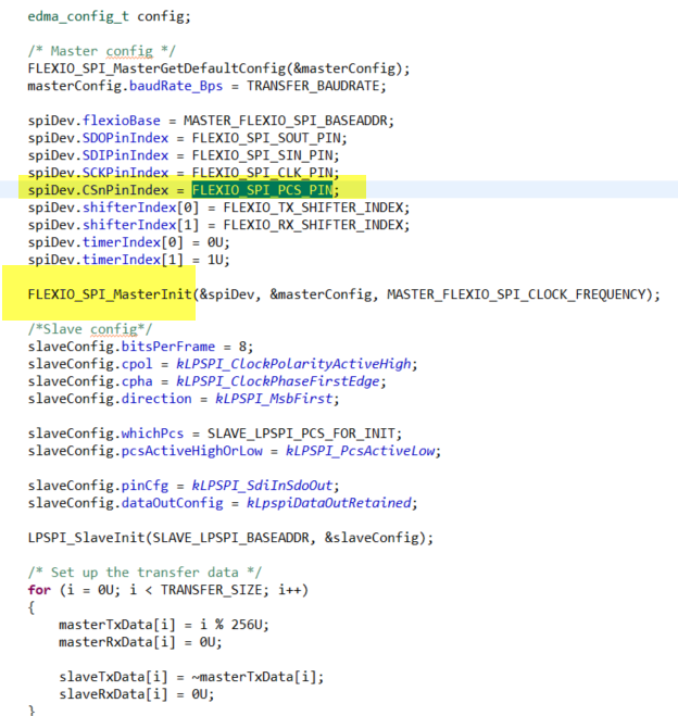

Hello Jack,
I guess you mean the CMSIS demo, in CMSIS, functions includes SPI Initialize, SPI send and others all
build in to cmsis lib.
I recommend you use SDK driver and demo:
we can find the configuration clearly :
TIC

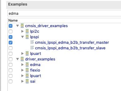

jackking
Senior Contributor I
That code that you posted doesn't exist in the IMXRT SDK example for lpspi.
SDK_Import_Wizard_and_workspace_-_evkbimxrt1050_cmsis_lpspi_edma_b2b_transfer_master_dma_spi_master_source_cmsis_lpspi_edma_b2b_transfer_master_c_-_MCUXpresso_IDE.jpg
It only has:
Which doesn't set PCS or frame size...
Here is the full example code:

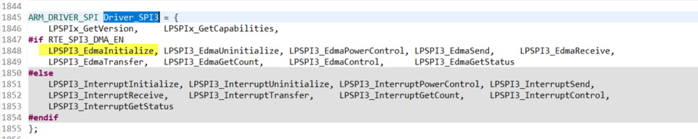

Hello Jack,
You can find the SPI configurations with DRIVER_MASTER_SPI:
-> #define DRIVER_MASTER_SPI Driver_SPI3
Then run into the functions , you will find SPI configuration in detail .
Hope it helps,
