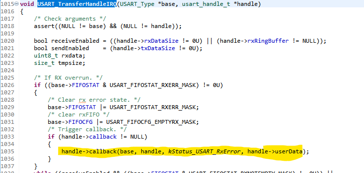

When an RX fifo overrun occurs, the callback is called as below:
To support this event, I added this code to KSDK_USART_NonBlockingCallback() in fsl_usart_cmsis.c:
    if (kStatus_USART_RxError == status)
    	event = ARM_USART_EVENT_RX_OVERFLOW;
