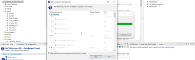

After checking your issue, when you click on refresh SDK components directly with the right-click on the project, it appears to you a screen like this, right?
It is supposed that some header files are going to be replaced with the newest version, however, the source files from your project can only be updated or replaced by adding SDK components (for example if you need another driver to your application), so please, let me know what did you see when you do the process that I made in the picture, and what are you expecting to reach.

I have followed the steps you mentioned in the IDE, and what happens in my newly created project is that 52 new header files appear in my project directory. These files were previously all referenced as links to their location on disk via the top level 'Includes' item in the project tree. Also, there are some additional paths added in the .cproject file:
