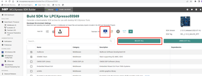

I am having issues extracting SDK built with the online Builder.  The resulting .gz file produces one large file not a directory.
1,877件の閲覧回数
mwilliams
The SDK I built is attached and it has a .gz extension, I found that after decompression the file is a tar archive but the name gives no indication.  After I decompress with gzip, I had to notice that the result was a tar archive and after extracting that I was able to use the SDK on the command line to build some examples.

I just download a SDK linux version. the extension is .zip and it can be installed to MCUXpresso IDE by dragging the package to "installed SDK " window.
I use Ubuntu.
So there is no install problem on my side.
Could you please test the same?

Thanks for your reply.  Could you give the versions of SDK, MCU Expresso, and platform?

Hi mwilliams
You use iMX8M. Our  iMX support will help you.
