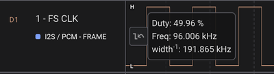

Using the RT1170EVK and SDK v2.15, I'm seeing the SAI produce a bit clock & FS clock that is double what is expected. Master clock is correct.

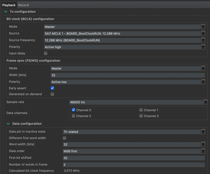

You can see in my SAI peripheral config, the input clock is 12.288MHz, bit clock is 3.072MHz and FS clock is 48kHz.

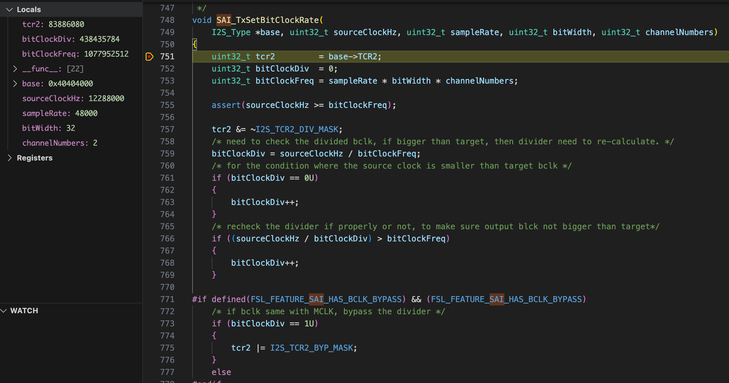

When I debug, I can see the correct values being passed in (See on the left)
But when I measure the output, MCLK is correct and FS clock is 96kHz.

Minor update: I've noticed that if I lower the SAI1 source clock to 6.144MHz, the bit clk and fs clk will be correct. This would indicate that the master clock cannot be divided down enough to provide the required rate, but looking at the DIV field in the TCR2 register, the rates I have given above should be achievable?

I stepped through the driver where it writes the DIV field in the TCR2, and I see it writing the correct value, but the clock output is wrong. I then manually set the TCR2 register in my application code, and the clock becomes correct. I then remove the code where I manually set TCR2, and it stays correct.
