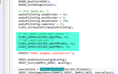

1 In your callback I recommend you all of the possible status you can get from the SPDIF. Or directly debug into your SPDIF_TransferRxHandleIRQ().
2 Is the kSPDIF_RxFIFOFull  status being sent? This is where the SPDIF_TransferRxHandleIRQ() copies data from internal SPDIF buffers to your audioBuff. Below an screenshot.
3 You can check if the sample rate matches to the expected frames  calling the  function SPDIF_GetRxSampleRate() .
Actually this function requires you to give clockSourceFreq_Hz for your SPDIF.
4 In your provided code, I have not seen, which clock divider you are providing to your SPDIF initialization.
Here is an example below:
5 I am attaching an SPDIF example for the RT1050. This demo receives SPIDIF data and then does a transmission.  You can actually double check muxing for your IN pin from the demo.

3. I tried this in my receive-callback in case of a kStatus_SPDIF_RxIdle:
const uint32_t clock=CLOCK_GetPllFreq(kCLOCK_PllAudio);
sRate=SPDIF_GetRxSampleRate(SPDIF_PERIPHERAL,clock);
clock is 24000000 (somewhat surprising as the clock configuration says the SPDIF is running at 30 MHz). SPDIF_GetRxSampleRate() never returns, it fails at this loop which never becomes true:
while ((base->SRPC & SPDIF_SRPC_LOCK_MASK) == 0U)
4. This is part aof the auto-generated code. The clock-config-tool says, this should result in a 30MHz clock fpr the SPDIF:
/* Set SPDIF0_CLK_PRED. */
CLOCK_SetDiv(kCLOCK_Spdif0PreDiv, 1);
/* Set SPDIF0_CLK_PODF. */
CLOCK_SetDiv(kCLOCK_Spdif0Div, 7);
/* Set Spdif clock source. */
CLOCK_SetMux(kCLOCK_SpdifMux, 3);

Hi @Elmi77
Many thanks for your reply and patience!
Regarding #1 and ##2,, I understand, that even the IRQ goes to copy receive buffer contents to your array, the data copied is zero.
Regarding, #3
It seems that we are having problems to recover the SPDIF Rx clock, that may explain why the function.
 SPDIF_GetRxSampleRate() is is stuck in.
If we look into SRPC register, the function is waiting for the  DPLL to be locked. The internal DPLL is the one in charge of measuring the frequency of SPDIF Rx clock. I would think the issue we are seeing is because clock settings.
Regarding #4,
I would suggest, trying the transmitter side. I just want to see if you are able to even transmit data. Try to mimic the demo code clock selection and divider settings.
Regarding #5, understood.

don't worry about the delay. About the DPLL clock problem, there are following observations:
  1. In my clock configuration I have set dividers which result in 30 MHz clock for SPDIF0. Nevertheless CLOCK_GetPllFreq(kCLOCK_PllAudio) returns a value equal to 24 Mhz - shouldn't thry bes the same?
  2. There are some more problems with the clock not behaving like documented and expected, I asked about them in an other thread: https://community.nxp.com/t5/MCUXpresso-Config-Tools/Run-RT1010-with-internal-clocks-only/m-p/152008... - may be this is related?
Your suggestion to add the code-part to transmit some data via SPDIF was not yet successful:
  • I added the SPDIF-out-pin to the pin configuration
  • I extended the peripheral-configuration to deal with Rx and Tx using a Tx clock of 100 kHz (same as my incoming SPDIF-stream) and I added the following code based on your example:
static spdif_handle_t   txHandle      = {0};
static spdif_transfer_t txXfer        = {0};
#define BUFFER_SIZE 96
AT_NONCACHEABLE_SECTION_ALIGN(uint8_t audioBuffRx[BUFFER_SIZE], 4);
SPDIF_TransferTxCreateHandle(SPDIF_PERIPHERAL, &txHandle, txCallback, NULL);
txXfer.dataSize = BUFFER_SIZE;
txXfer.data = audioBuffTx;
ret=SPDIF_TransferSendNonBlocking(SPDIF_PERIPHERAL, &txHandle, &txXfer);*/​
Surprisingly this dies when jumping into SPDIF_TransferSendNonBlocking() - yes, when jumping into that function, not somewhere inside it.
So...may be there is something fundamental wrong here?
