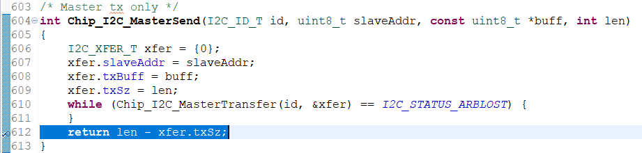

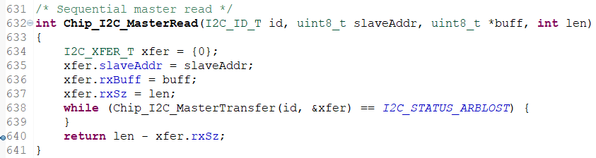

I tried to debug with breakpoints as below.
And here is my test code snippet ------------
  uint8_t slaveAddr = 0x19;
  uint8_t regAddr = 0x20;  // 0x0F;
  uint8_t readData = 0;
  int result = 0;
  Chip_I2C_MasterSend(I2C0, slaveAddr, &regAddr, 1);
  result = Chip_I2C_MasterRead(I2C0, slaveAddr, &readData, 1);
(1) For "Chip_I2C_MasterSend" procedure, "Chip_I2C_MasterStateHandler" hit the breakpoint and finally "Chip_I2C_MasterSend" hit the breakpoint, that is, the operation was successful.
(2) But for "Chip_I2C_MasterRead" procedure, both "Chip_I2C_MasterStateHandler"  and "Chip_I2C_MasterRead" never hit the breakpoints!
Here is the problem I met.
Any idea how I should debug to dig out the root cause?

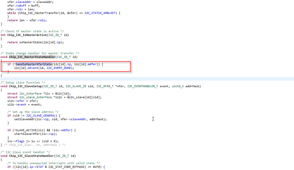

/* Chip event handler interrupt based */
void Chip_I2C_EventHandler(I2C_ID_T id, I2C_EVENT_T event)
    struct i2c_interface *iic = &i2c[id];
    volatile I2C_STATUS_T *stat;
    /* Only WAIT event needs to be handled */
    if (event != I2C_EVENT_WAIT) {
        return;
    stat = &iic->mXfer->status;
    /* Wait for the status to change */
    while (*stat == I2C_STATUS_BUSY) {
/* Chip polling event handler */
void Chip_I2C_EventHandlerPolling(I2C_ID_T id, I2C_EVENT_T event)
        return;
    /* Call the state change handler till xfer is done */
        if (Chip_I2C_IsStateChanged(id)) {
            Chip_I2C_MasterStateHandler(id);
Arna

Kan_Li
Hi Arna,
Yes, your understanding is right. I2C_STATUS_DONE is set in handleMasterXferState(), which is called in I2C0_IRQHandler() or Chip_I2C_EventHandlerPolling(), but what ever you used for the event handler, you may just set a breakpoint at the following line:
you may know if this state is set during your test, there is no printf() needed for that purpose.

Kan_Li
Hi Arna,
Sorry for the misunderstanding, what I mean is Printf() is not recommended using in an ISR, but ok if you put it in Chip_I2C_EventHandlerPolling() or Chip_I2C_EventHandler(). and from the log, the I2C seems work well as the state changing shows it starts from I2C_EVENT_LOCK to I2C_EVENT_UNLOCK, it means the master transfer is complete, so it should no be stuck in the while loop, the reason why you didn't see I2C_STATUS_DONE is due to this state is only set in Chip_I2C_MasterStateHandler(), which is called in Chip_I2C_EventHandlerPolling(), not Chip_I2C_EventHandler().
