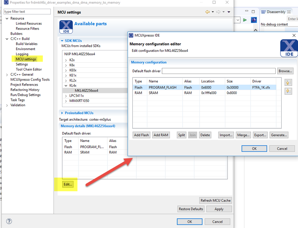

I have used MCUexpresso IDE for the arm application development. In the target chip, I will put two programs: one is start at zero (normally), the second is from 0x6000. My question is how to configure the IDE so that it will be build at location: 0x6000 (default is 0x0000)?

Hello Zhong Shen,
You can  configure the "Memory configuration editor" , just like below :
About the detail, please check  MCUXpresso_IDE_User_Guide.pdf -> 14.8 Using the Memory Configuration Editor
Hope it helps
