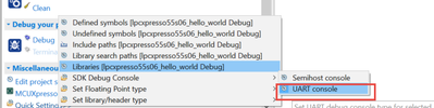

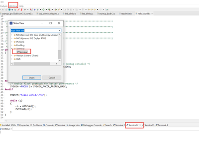

Hello @jmreina
You can simple use the Terminal of MCUXpresso IDE:
Also pay attention please choose "UART console" with your project:
If still can't work, take a video or screenshot show your steps and take a photo about your board connection, thanks.
