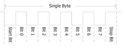

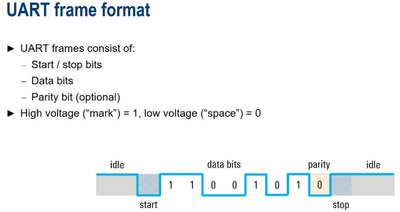

Hello, how do you know that information is right? I reviewed the datasheet of the LCD, and this has a chapter about Serial communication and has the same standard protocol.
4. Hardware Interface - Pins.
gen4-uLCD-43D Series - 4D Systems' Resource Centre (mouser.com)
スポイラ
image from the web as example.
This is not similar that you are seeing on the oscilloscope.
Let me know if the datasheet that I found is not the right.
