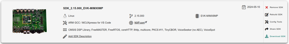

Hello everybody. I am moving my first steps in developing firmware for Cortex-M7 in i.MX8MP processor...
Following the guides, I built, downloaded and installed a MCUXpresso SDK for my EVKIT:
