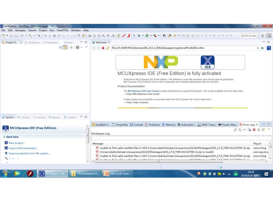

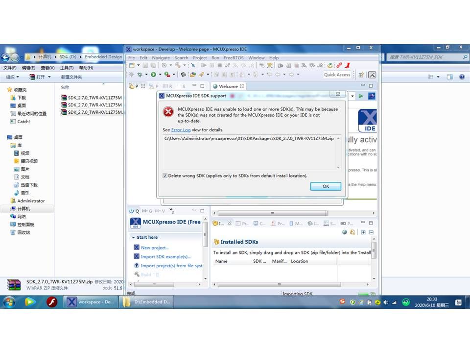

I have a problem when i import SDK project file. Detail in below picture. Could you please give me some advise to solve this problem?

Hi Banson,
I recommnend you to:
  • Make sure the SDK  is generated for MCUxpresso IDE.
  • Upgrade to the latest version of MCUxpresso IDE.
Diego.
