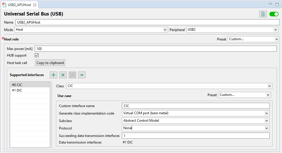

I'm trying to bring up a USB CDC host instance on an RT1050, specifically on USB2.  (I've verified port USB1 is functional for the serial downloader.)  I'm using SDK 2.6.1 on a custom board with an RT1052 (MIMXRT1052CVJ5B) and MCUX 11.0.1.
I'm using the middleware component of MCUX to generate the code for both the CDC device instance on USB1 (not tested yet) and the CDC host instance on USB2.  Here's my configuration screen for USB2:
Pretty standard stuff.  I'm letting MCUX generate all the necessary source code, then I'm making copies of a couple of the generated files (usb_host_interface_0_cic.c and usb_host_app.c), customizing those, and removing the originals from the build configuration.
I don't have it working yet, and I'm still debugging that, but I think I've noticed one glaring oversight in the generated middleware code; I believe that usb_host_app.h is calling out the wrong EHCI instance.  Here's the source:

So in USB_HostIsrEnable(), clearly what's going on is if USB_HOST_CONTROLLER_ID is kUSB_ControllerEhci0, that yields an array index of 0, pointing to USB_OTG1_IRQn.  If USB_HOST_CONTROLLER_ID is kUSB_ControllerEhci1, then the array index is 1, pointing to USB_OTG2_IRQn.  Seems clear that EHCI0 --> USB1 and EHCI1 --> USB2.  This is also borne out by USB_HostClockInit(); if the host controller is defined as EHCI0, then the "Usbhs0" PHY and module clocks are initialized, whereas if EHCI1 is selectedn then "Usbhs1" clocks are initialized.
So why is the middleware generating this line:
#define USB_HOST_CONTROLLER_ID kUSB_ControllerEhci0
It seems pretty clear that USB2 corresponds to EHCI1, not EHCI0, unless I'm misinterpreting the startup code.  Further, in the usb.h header file, there's this block of definitions:

The comment reads, "EHCI 1U, Currently, there are no platforms which have two EHCI IPs, this is reserved to be used in the future."  It would seem that this is no longer true, as the RT1050 has two EHCI controllers, EHCI0 for USB1 and EHCI1 for USB2.  Is this correct?
Please let know if I'm understanding this issue correctly, and whether I should edit usb_host_app.h to read:
#define USB_HOST_CONTROLLER_ID kUSB_ControllerEhci1
David R.

Hi   David R :
This is an issue in USB configurator. Host controller is not indexed properly and will be fixed in next release.
Workaround is to use Host on USB1 and device on USB2. Indexing of device controller works.
Thank you again for your sincere feedback.

marek_neuzil
Hello David,
We have fixed the issue of the USB component in the Peripherals tool data (the USB controlled ID is correctly generated in the usb_host_app.h file). You can use the attached package and fix the USB component in your local MCUXpresso Config Tools data (see the readme.txt in the attached archive for details).
Marek Neuzil

dmarks_ls
Senior Contributor II
Hi Daniel,
Understand that this is not an effective workaround for custom hardware; we have one USB port (device) that runs to a micro-B connector, and one USB port (host) that runs to two pins on a card edge connector for communication with another board in the backplane.  These ports are physically distinct and cannot be logically reassigned.  I'll continue to modify my usb_host_app.h file as a workaround.
This also tells me that there was not sufficient testing done on the SDK USB host code prior to product release, if the USB host function was never tested on the USB2 port.
David R.

danielchen
The host controller is hardcoded to have index 0 in current USB configure.
