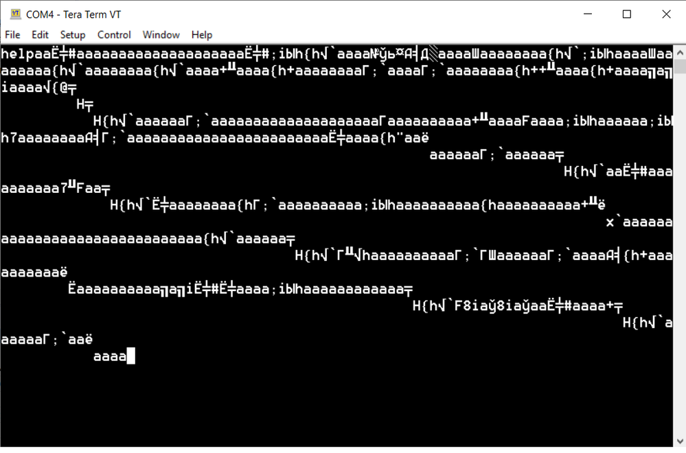

Alignment error in "serial_port_usb.с"  SDK_2.7.0_FRDMK64

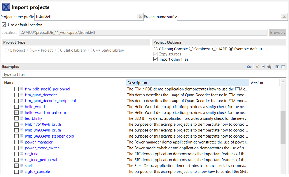

A project was created on the basis of two projects "hello_word_virtual_port" and the project "shell".
When the project was launched, the output of non-correct data to the console occurred.
The problem is alignment of the pointer to the output.
I solved the problem using an intermediate buffer aligned.
line 862  file serial_port_usb.с
if (needToPrime)
if (kStatus_USB_Success !=
USB_DeviceCdcAcmSend(serialUsbCdc->cdcAcmHandle, USB_CDC_VCOM_BULK_IN_ENDPOINT, buffer, length))
serialUsbCdc->tx.busy = 0;
return kStatus_SerialManager_Error;
