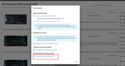

I have installed MCUXpresso IDE v25.6.136 on my computer and downloaded SDK_25_12_00_MCXE31B from the official website.
I imported the example projects from the SDK into the IDE, and they can be compiled normally.
However, when I open the configuration tool inside the IDE to configure pins, an error pops up on this interface:
"The processor MCXE31B is not supported or processor data is unavailable. Please check your network connection."
But my network is working fine. Please help me.

Hi @hyf_grass
You can download the MCXE31B config tool data from the official website.
After decompressing the folder, place the relevant files in the corresponding folder.
C:\ProgramData\NXP\mcu_data_25.06
Then you will successfully open the pin config in the MCUXpresso IDE.
Harry
